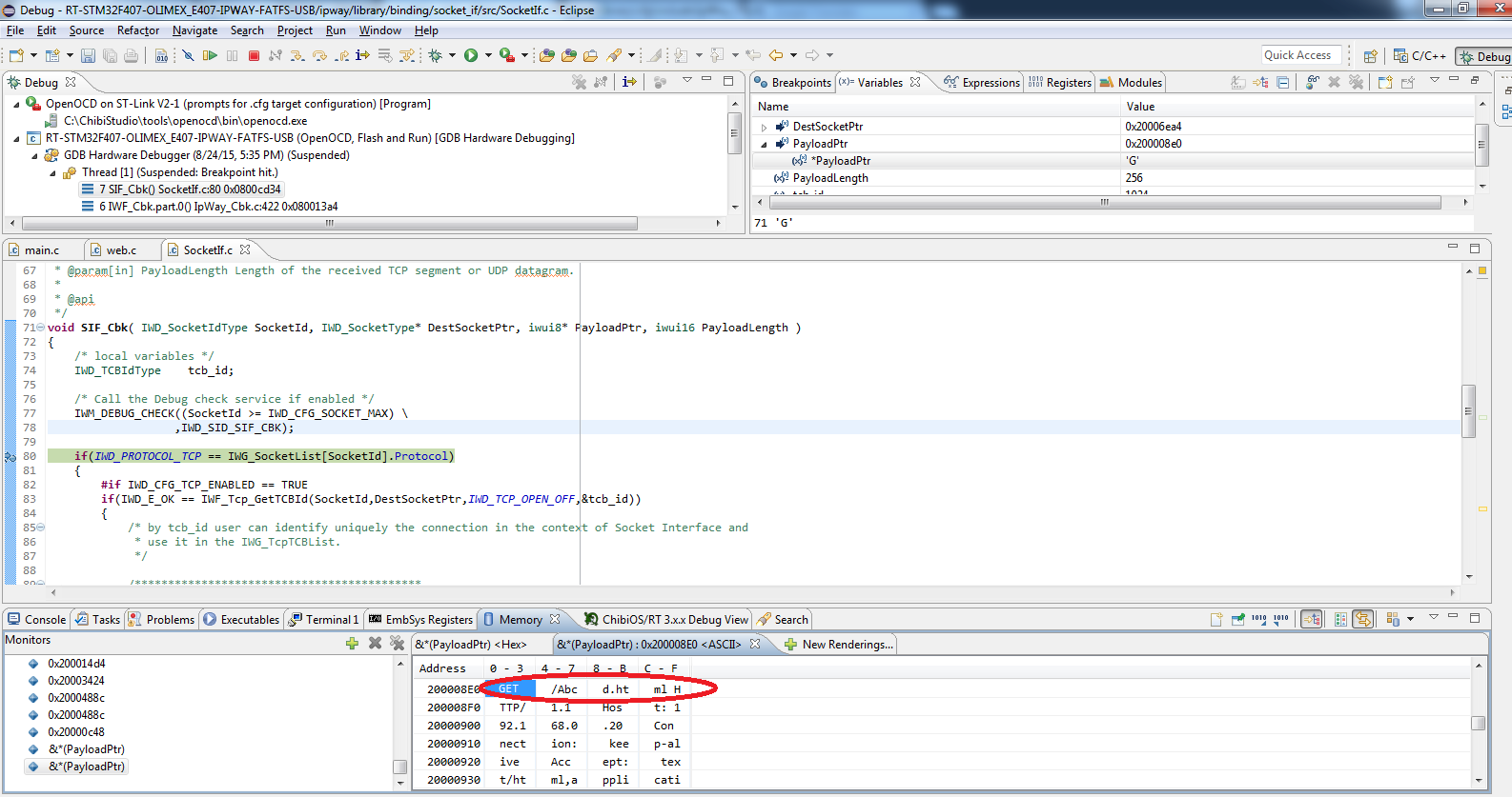

I put in attached the screeshot that shows the correct Abcd.html.png page in the memory, when PC is in SIF_Cbk() function...let me know...
Did you modify something in IpWay_Cfg.h file?
Best Regards
Gianni.
