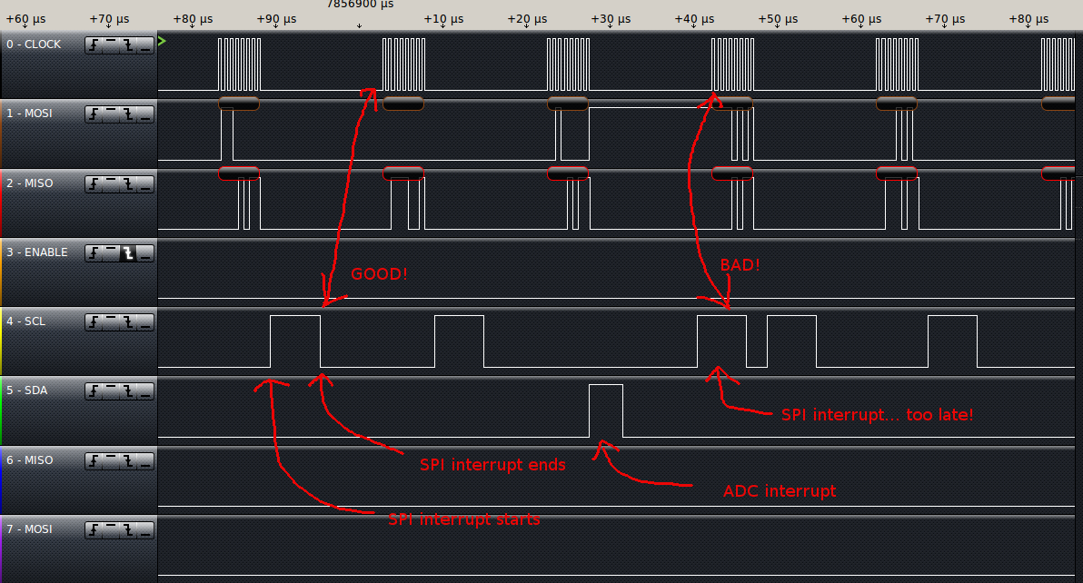

I have an SPI master-slave system with the slave being an STM32 running chibios.
Chibios doesn't support SPI slave mode, so I'm handling the hardware myself. No problem. :-)
I have to implement the SPI protocol which is not ideal: after the master sends a byte the slave has to figure out what to send back during the following byte (frame). This cannot be done in advance, as the data depends on what the master sends.
So... all is fine and dandy, except that I also have an ADC running. The DMA complete interrupts from those cause enough delay to mess up the SPI protocol. I have already moved the processing of the ADC data to a thread and just wake up the thread instead of processing it in the callback. But still the interrupt overhead is too much. (My ADC callback is now taking 4 microseconds, in my current trace 8 microseconds are available, so the "tail" of the adc interrupt seems to be taking at least 4 microseconds too. )
Anyway... I want the SPI interrupts to have a higher priority than the ADC interrupts, so that the ADC interrupt is .... well... interrupted by the higher priority interrupt.
How can I achieve this? I have tried:
#define STM32_ADC_ADC1_DMA_PRIORITY         1
#define STM32_ADC_ADC1_DMA_IRQ_PRIORITY     1
#define STM32_SPI_SPI1_IRQ_PRIORITY         2
#define STM32_SPI_SPI2_IRQ_PRIORITY         2
but still the SPI interrupt is postponed until it is too late....
larger version: http://prive.bitwizard.nl/spi_vs_adc.png

I spent some time figuring out what interrupt triggers the ADC callback. Stopping the CPU in the ADC callback shows a call stack that starts with "Vector64" Divide by 4, subtract the 0x10 reset, NMI and other system vectors, I think that this is IRQ9. (The math checks out for my SPI2 IRQ, where VectorA8 divide by 4, subtract 0x10, ends up at 0x1A or 26, the correct number for SPI2.).
And clearing bit 9 by hand from the debugger will quiet down the ADC callbacks for 100%....
Is there a bit in the ADC that would cause it to suspend operations (during the SPI transfer)? ADEN? Would it resume where it left off if that's the only thing I touch? This is a much worse workaround than just disabling the ADC interrupts for the time of the SPI transaction. The ADC interrupt can easily be served after the SPI transaction. The service time is just around 8 microseconds (including the context switch), and it needs to happen about once every 1.4 ms. A long-ish SPI transaction takes around 0.4 miliseconds (*). So postponing the ADC interrupt for 0.4 ms is completely possible. Stopping the ADC altogether means I'm... ehh.. stopping the ADC.
