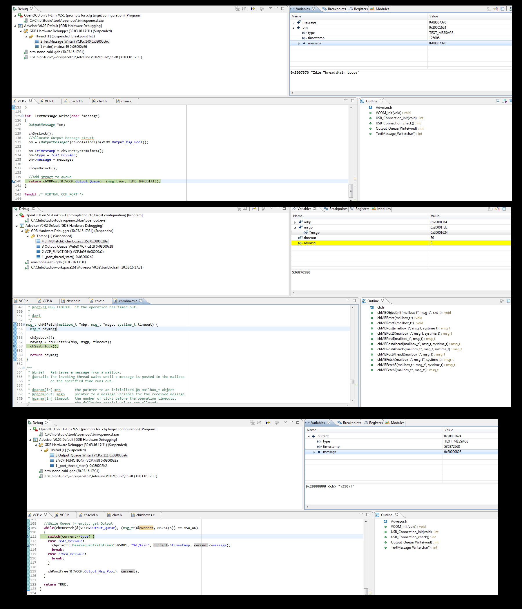

Yes but my actual problem is, that the pointer, when I recieve it, does not correctly point to my Message-struct.
You can see in the first Picture, that the Pointer to the OutputMessage *om = 0x20001624.
That does mean the Message Object is at this address, right?

Compare Picture 1:
om->message = 0x08007370
