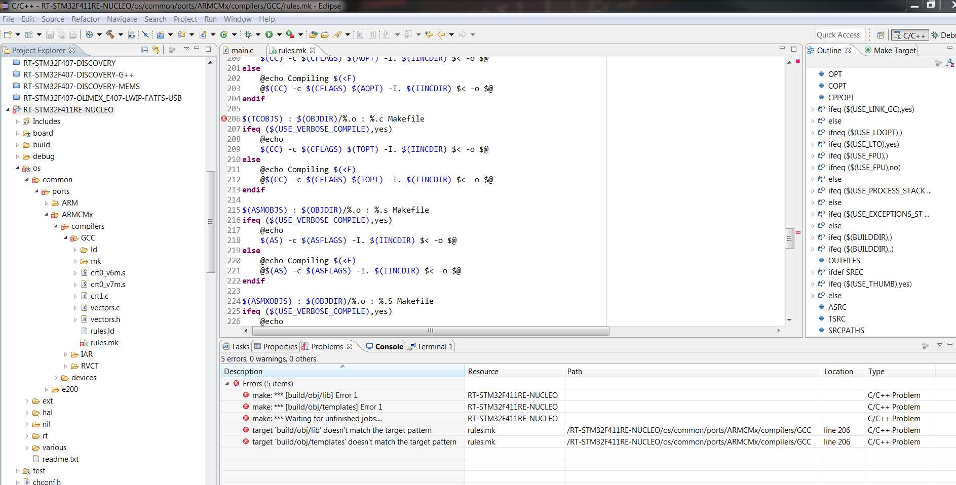

This is actually my third time trying chibiStudio. See, I've finally figured out a few things about how makefiles work, so now I'm trying to get a couple project templates built for myself.
So, starting from the demo projects there is a makefile issue.
Googling tells me it is likely a makefile issue anyway... maybe the problem is something else. Anyone know what this error means?
I only made a fresh download of chibiStudio from sourceforge 2 days ago, but there are no demos or board files for the Nucleo 144s. Is this the most current version of chibiStudio I should be using? I noticed that the truck of chibiOS has a different directory structure.
Let me know what I've done wrong if you have some idea, thanks all!
See attachment:

It would be more useful to see the console log.
Note that ChibiStudio has 4 workspaces:
- Version 2.6.x projects.
- Version 3.0.x projects.
- Version 16.1.x projects (current stable).
- Latest code.
The demo for the 144 should be in the latest code, if not then update the chibios_trunk directory in chibistudio with code checked out from the repository.
About the error, is ChibiStudio installed as C:/ChibiStudio ? are you launching it using the provided links? you should not launch Eclipse directly.
- Latest code.
