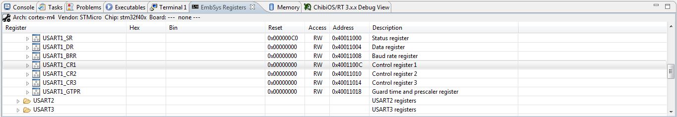

Following is the what i tried but unfortunately same result.
Now i am trying with configuring register without STM_HAL.
So this time also not working. I am configuring USART register then also it is showing unchanged in register window.
here is my configuration.
#define PCLK2_FREQ  36000000
#define BAUD_RATE   19200
#define  USART_CR1_RE                        ((uint32_t)0x00000004)            /*!< Receiver Enable */
#define  USART_CR1_TE                        ((uint32_t)0x00000008)            /*!< Transmitter Enable */
#define UART_OVERSAMPLING_16                    ((uint32_t)0x0000)
#define UART_PARITY_NONE                    ((uint32_t)0x0000)
#define UART_WORDLENGTH_8B                  ((uint32_t)0x00000000)
#define  USART_CR1_UE                        ((uint32_t)0x00000001)            /*!< USART Enable */
#define UART_MODE_TX_RX                     ((uint32_t)(USART_CR1_TE |USART_CR1_RE))
void init(void)
  palSetPadMode(GPIOA, 9, PAL_MODE_ALTERNATE(7));       /* USART1 TX.       */
  palSetPadMode(GPIOA, 10, PAL_MODE_ALTERNATE(7));      /* USART1 RX.       */
//  utils_sys_lock_cnt();
  RCC->APB2ENR |= 0x00002000;
  USART1->CR1 = (UART_WORDLENGTH_8B | UART_PARITY_NONE | UART_MODE_TX_RX | UART_OVERSAMPLING_16);
  USART1->CR2 = UART_STOPBITS_1;
  USART1->CR3 = (UART_HWCONTROL_NONE | UART_ONEBIT_SAMPLING_DISABLED);
  USART1->BRR = PCLK2_FREQ/BAUD_RATE;
  USART1->CR1 |= (USART_CR1_UE | 0x00000020);
here is attached snapshot.
