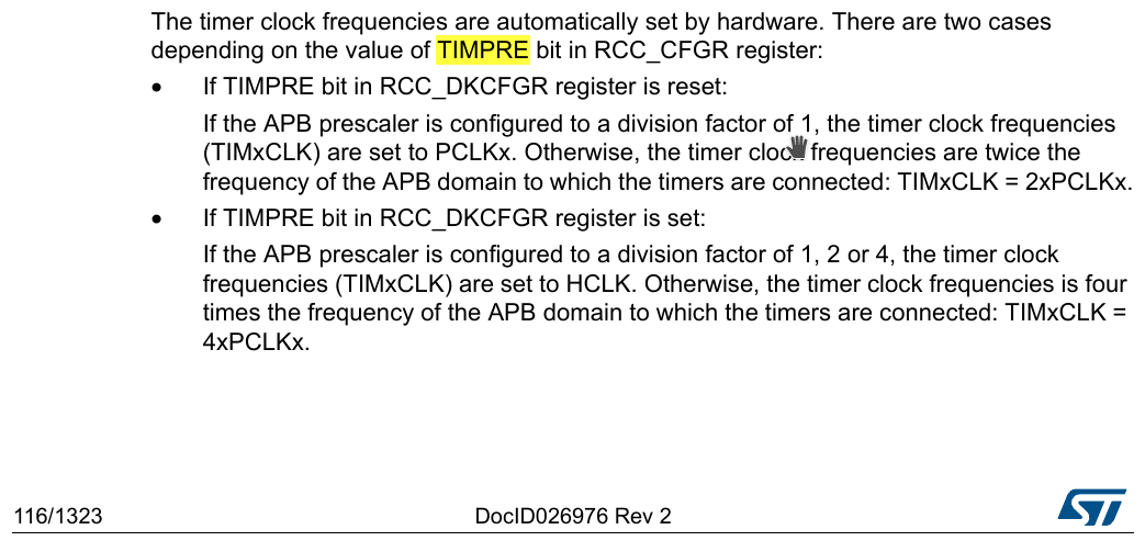

Newer MCU of the STM32 family received this new feature that allows the MCU to clock the APB1 connected timers at the rate of the AHB bus. The screenshot below is a relevant excerpt from the STM32F446 user manual:
Currently ChibiOS (neither the latest release nor trunk) does not support the case when TIMPRE=1. Can one hope to see this feature supported in the next release?

Seems like this feature is only supported for STM32H7 at the moment (by virtue of STM32_TIMPRE_ENABLE). Are there plans to support it for STM32F4? Currently, my application has to tinker with registers manually to work around the lack of this feature.

The F446 is similar in regard to TIMPRE except that F446 (according to the RM) applies the multiplier for APB pre-scaler values > 4.
Whereas the F413 only does so for pre-scaler values > 2.
I've made the changes to support the F446 TIMPRE and if this is of use to you the patch archive is attached.
