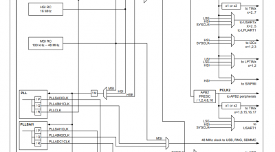

Post by RoccoMarco »
to clock the USB you just have to enable MSI and set MSI range as 48 MHz, then select CKL48 source as MSI
in mcuconf this is done in this way:
#define STM32_MSIRANGE                      STM32_MSIRANGE_48M
#define STM32_CLK48SEL                      STM32_CLK48SEL_MSI
am I missing something?
