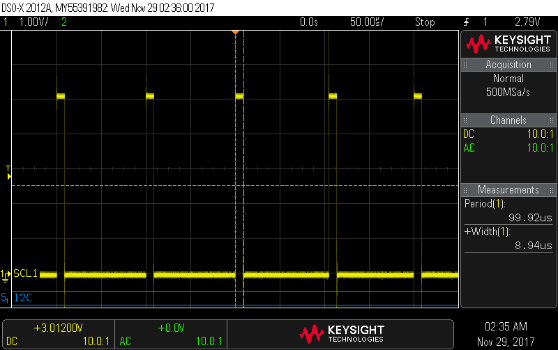

Hi folks,
I've been reading the code for the GPT module for the AVR port. This is one of the modules using timers in an ATMega chip. This module takes a frequency and a period parameter. From what I understand, the first parameter sets the frequency in Hz for the timer clock and the second the number of clock pulses the time interval provided by the GPT takes. The problem is that the timer clock prescaler in the AVR timers can only take on a small number of values (7 for timer2 and 5 for the others). The current GPT implementation tries to make the frequency values more flexible by combining the few prescaler values with the compare-and-reset register (OCRA). So, for example, if you want a 10 kHz frequency, and if the F_CPU is 16 MHz, you can choose a prescaler value of 64 and set OCRA to 24 = 25 - 1, for example. This will make the frequency of the match-reset event to be 10 kHz and that would be the frequency of the GPT timer. This forces, however, the implementation to update the period counter in an ISR, which is not a good thing, IMO, since you have the time to save all the registers used and the time to do the processing. Looking at the assembly listing, I suspected this could take more than 5 μs, and so I decided to set the pin at the beginning of the ISR and reset it at the end (done in the file hal_gpt_lld.c) to measure the time spent there. I took the testhal application for the GPT module in AVR port and used a frequency of 10 kHz and a period of 500 clock pulses, with the timer callback toggling the value of another digital pin. I burned the program in an Arduino Nano and measured the output of the pin used by the ISR with a scope. From there we see the ISR handling is almost 10 μs! That means the maximum frequency would be 100 kHz. If we make the frequency as 50 kHz and measure the output, we see the ISR handling is taking about 50% of the cpu time.
We can do better but either we forgo the flexibility on the frequency values, and settle down for the few allowed prescaler values, or we delay the clock initialization to the moment when we know both the frequency and the period, i.e, when calling gptStartTimer().
Would there be an interest in this kind of optimization? If so, which alternative seems more suitable?
I can try to implement it, if there is interest.
Thanks.
ISR handling time for f=50kHz
ISR handling time for f=10kHz
