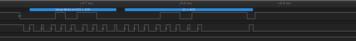

I managed to take a capture with a logic analyzer, this is produced by calling i2cMasterTransmit with 1 byte tx buffer and 3 bytes for the rx.
The write and cmd byte make it through, with the expected SCL clock, but when it is time to perform the start condition belonging to the 3 byte read, SCL remains permanently low until an application reset.
