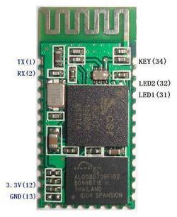

Mathias, I am a "wireless" fan so I am using cheap BT modules with my dev boards :) .
I redirected the usb to serial, and it works (even I have to get familiar with it a little bit)..
Maybe adding SDIO to log the maesurements on an sdcard would be nice to have :D (since I am still coping with the SDIO testhal demo :roll: )..
