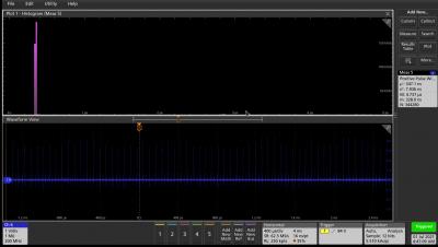

To analyze the execution time we measure the positive pulse width of that GPIO with an oscilloscope. Issue here is that 99% of the time the width is 350 ns but in some intervals the WECT takes up to 5us (see M:4.737us in the Meas5 window), which is 10X of the original one. That is the case for more of the functions in this thread that we removed from this example, in total that adds up to a WECT that is significantly larger than our mean time and kills our realtime requirements for the system (with a WECT of maxium 64us).
The blue signal is the timing measurement from GPIO D7 and the purple signal is a histogram for the high pulse width of the blue timing signal. The high pulse width (= time, the above shown code takes) is further analyzed in the "Meas5" box. There you can see e.g. the last measured time u and the max measured time M.
