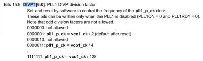

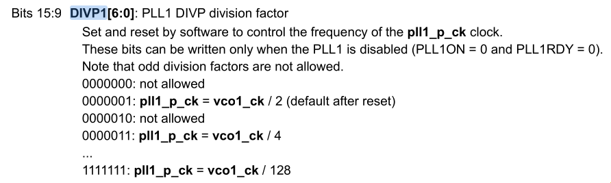

- the PLL1 divider P must not be set to odd values. PLL2/3 divider P and PLL1/2/3 divider Q/R do not have this constrain.
- also add the missing dividers for RCC_CDCFGR1_CDCPRE_DIVx (64, 128, 256 and 512) aka STM32_CDCPRE_DIVx
Patch for the current ChibiOS trunk (-r15856):
RM0455 Rev9 on page 404 (section 8.7.11 RCC PLL1 dividers configuration register (RCC_PLL1DIVR)):
