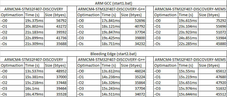

I ran a quick benchmark with the default toolchain vs Bleeding Edge toolchain. Attached are the results.
Setup:
I cleaned/compiled a couple demo projects in Chibistudio with various compiler settings:
ARMCM4-STM32F407-DISCOVERY
ARMCM4-STM32F407-DISCOVERY-G++
ARMCM4-STM32F407-DISCOVERY-MEMS
Rig:
AMD Phenom II P650 Dual-core 2.60GHz
Samsung 830 SSD
Conclusion:
Compile time and program size probably decreases while using Bleeding Edge toolchain. I can't speak of performance however.

- Comparison.png (30.98 KiB) Viewed 7884 times
Re: ChibiStudio preview 6
Good work. you could easily see the performance too, just run the test suite, the last test cases in the report are all benchmarks and quite accurate.
