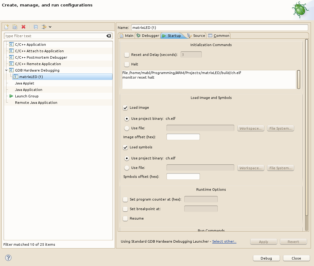

thanks for this great report! Today I did some real work debuging work in eclipse (i was using gdb directly before) and I was also not happy with the results shown in eclipse. It's hard to tell what exactly is wrong - but threads tend to display "wrongly".
I've discovered a workaround though: There are TWO debug frameworks in eclipse. I think you are currently using the "GDB (DSF) Hardware Debugging Launcher" while Giovannis ChibiOS plugin also only works with "Standard GDB Hardware Debugging Launcher"! The "Standard Launcher" gives me FAR better results - also on breakpoints! One problem though: Thread names are not displayed with it *grrrr* :twisted:
This also explains the "unresolved symbols"! You will have to check "Load Image" and "Load Symbols" checkboxes and in addition use the file command with the FULL path of the ELF. Here is an example screenshot:
Note, the selected debug launcher and the "file" command as well as the checked "Load image/symbols".

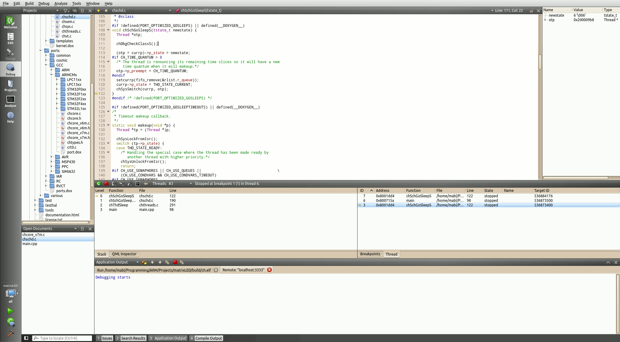

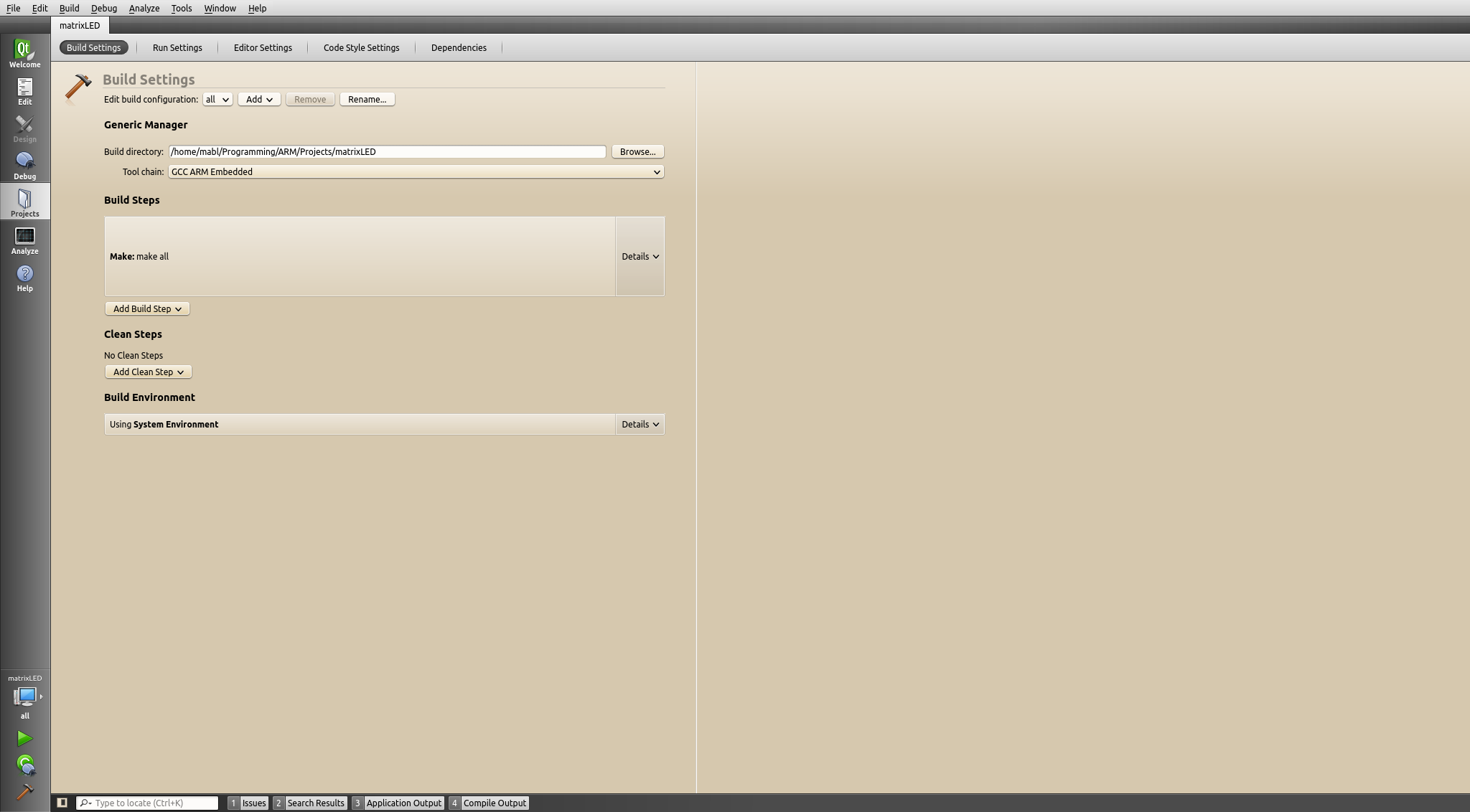

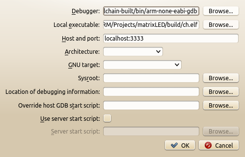

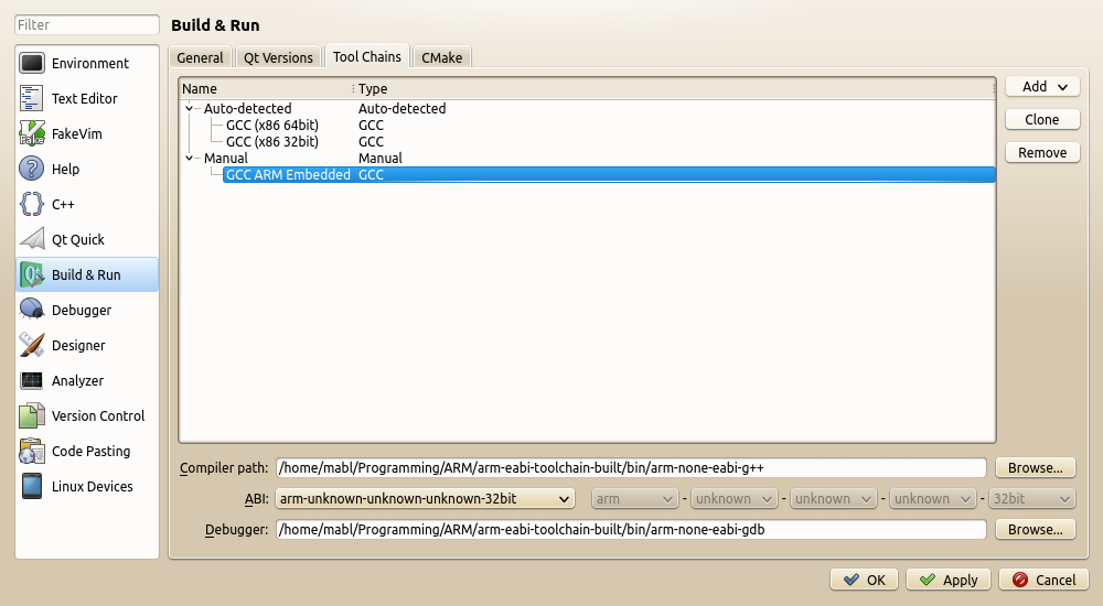

Ok, I checked out a lot of different IDEs: Netbeans, Code::Blocks, codelite - all had issues. But I think I just fell in love with qt creator:
mabl
Posts: 417
Re: ChibiOS OpenOCD support
Post by mabl »
Probably I still need a right startup file here. But it worked magically for now.
