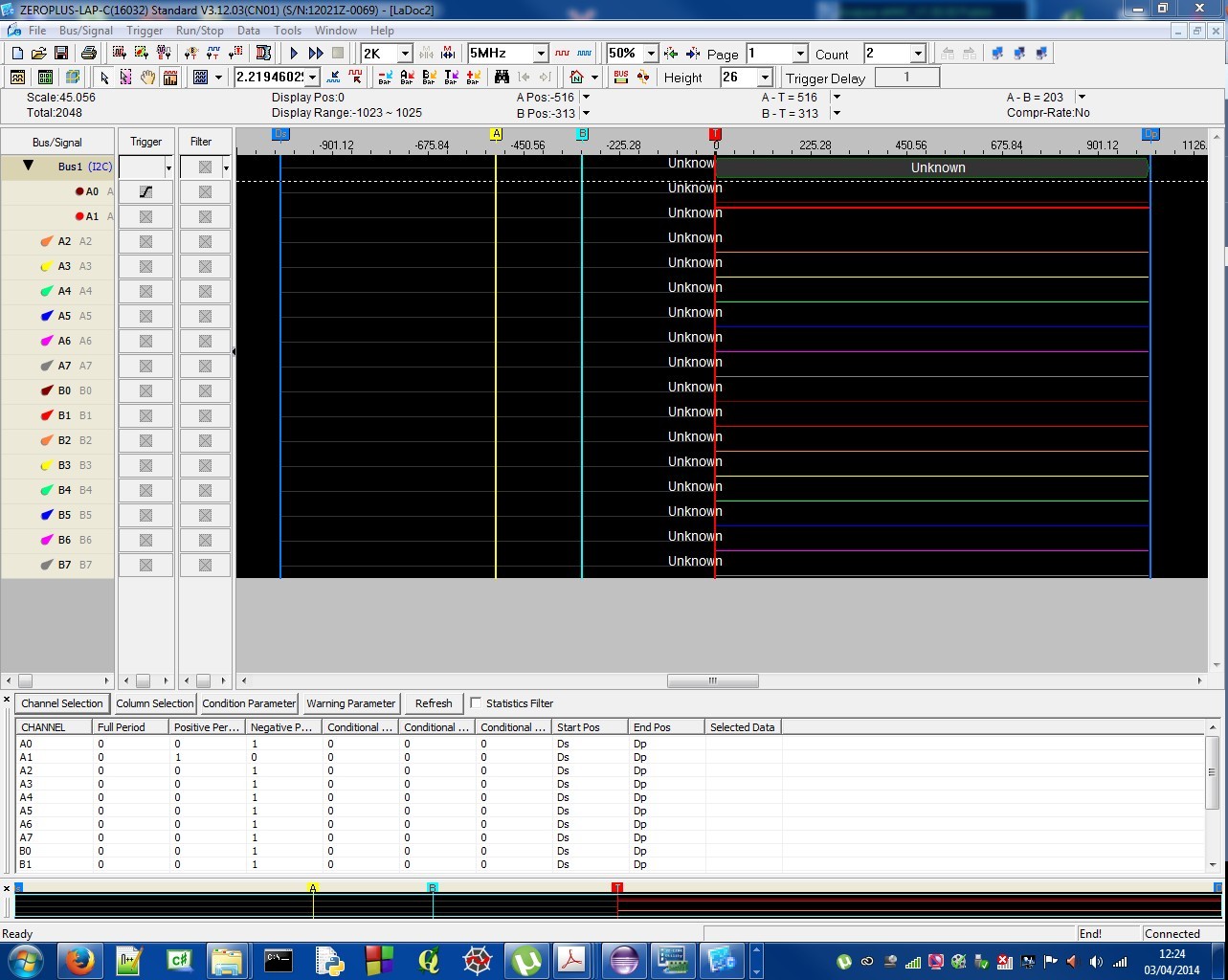

giazax
Posts: 12
Joined: Tue Nov 26, 2013 4:43 pm
Re: STM32F3DISCOVERY : using the I2C protocol
Post by giazax »
hi,
in attachment the display from the logic analyser....i see nothing.
(the settings are correct, I tested the analyser with the lsm303dlhc sensor on board)
giancarlo
Do you get a trigger? start the sampling just before the transmit operation (put a breakpoint there).
Also, try enlarging the samples buffer, it is set to 2k now, put it at 64k, may be we are not seeing anything because this.

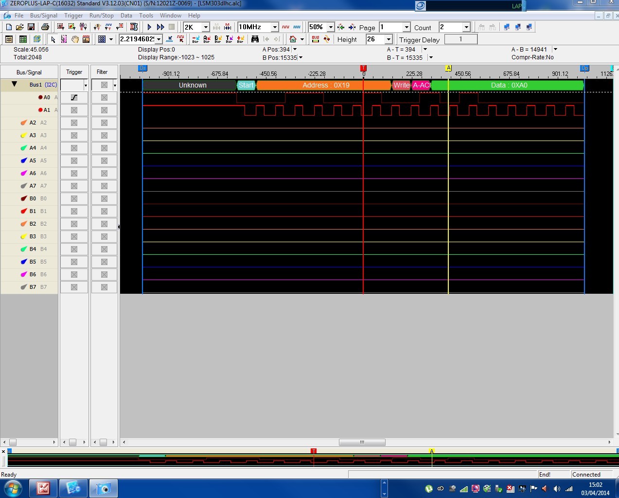

giazax
Posts: 12
Post by giazax »
hi giovanni,
in attach the display for the lsm sensor on board....it seems ok
is there any pins setup and/or other parameters i missed?
thanks for any suggestion
giancarlo
Put the buffer at 64K an try to read the whole sequence, then verify if all bytes are ACKed.
