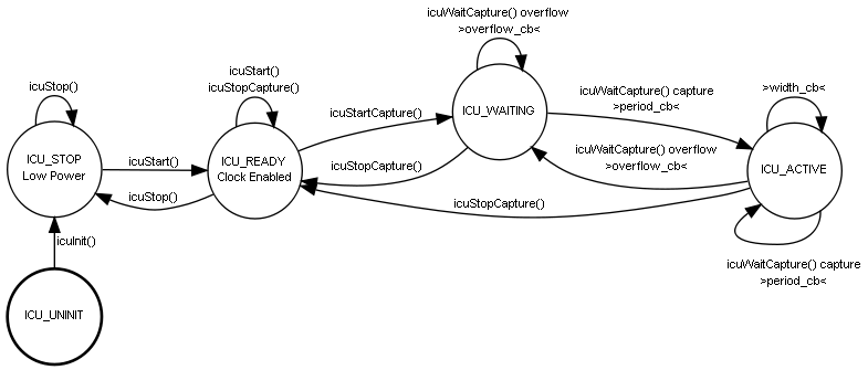

Re: ICU halt after icuWaitCapture on STM32F373 @ 3.0-git
This is the new behavior of the driver, overflows change the driver state back to waiting:
